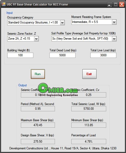

UBC 97 Base Shear Calculator
info:
I wrote up this app to perform some quick checks during designing with ETABS. As the title says it calculates the following as per UBC 97:
1. Seismic Coefficient, Ca
2. Seismic Coefficient, Cv
3. Period (Method A)
4. Maximum Base Shear as per code
5. Minimum Base Shear code
6. Design Base Shear percentage of load as per code
It would be my pleasure if anyone finds this useful. Suggestions/Comments welcomed! By the way, it would require the latest .net framework (v3.5) installed in your pc to run.
